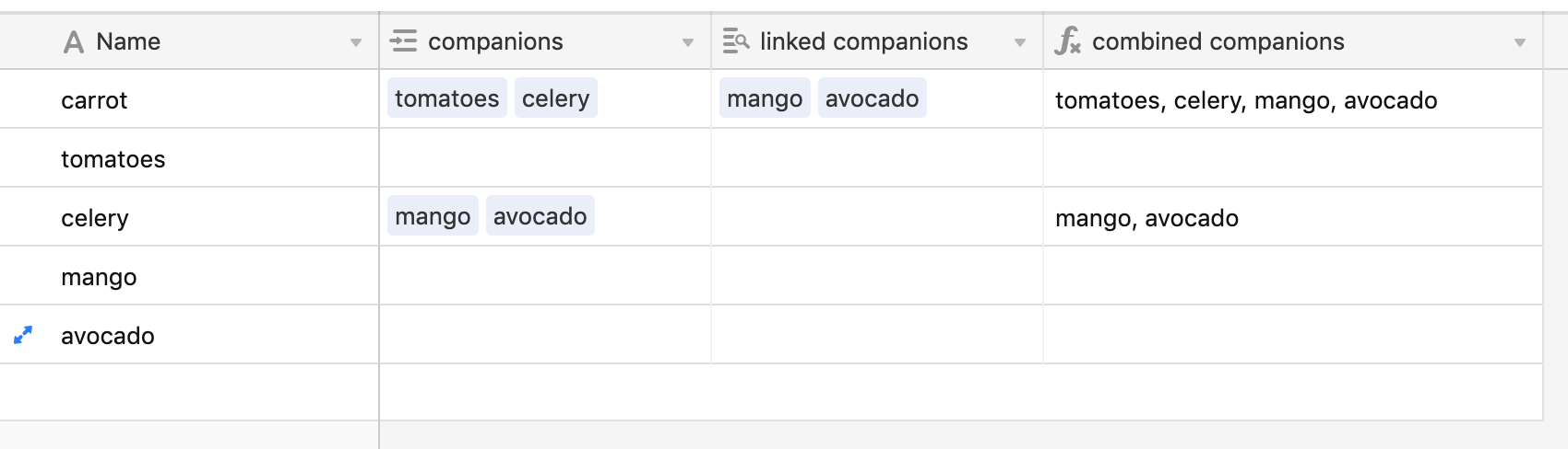

The scripting block would definitely allow you to construct a better solution. But here’s a formula attempt, which has a few notable flaws.
Linked Companions is a ‘lookup’ field. It’s getting the companions from all linked companions. ‘Linked Companions’ and ‘Companions’ are combined in the ‘Combined Companions’ field. Here’s the code for ‘Combined Companions’:
IF(AND({companions},{linked companions}),{companions} & ", " & {linked companions},{companions} & {linked companions})

Ahhhhh that’s smart. Thank you.

Hmm… actually, this doesn’t quite seem to work.
What I would want in that example is for tomatoes and celery to list “Carrot” as a linked companion and mango and avocado to list “celery” as a linked companion. I thought I’d be able to sort through it after you pointed out the obvious addition of the linked companions field, but Airtable keeps tripping me up with some restriction or another every time I think I have a solution.

What you’re requesting is that you want Airtable to automatically create the “reverse links” or “back links” for the records that you have already linked to in other records.
Unfortunately, this automatic functionality ONLY exists when linking to a different table — but it doesn’t exist when you “self-link” to the same table.
I recently created a product suggestion about this last month. You can add your comments to this thread:
The only way that you can currently do what you’re requesting is to manually do it some way.
I’m sure that other people have probably figured out some JavaScript that can do this (using Airtable’s new Scripting Block), but note that the script would need to be manually run every time you want to get the reverse links — so it’s still not an automated process.
