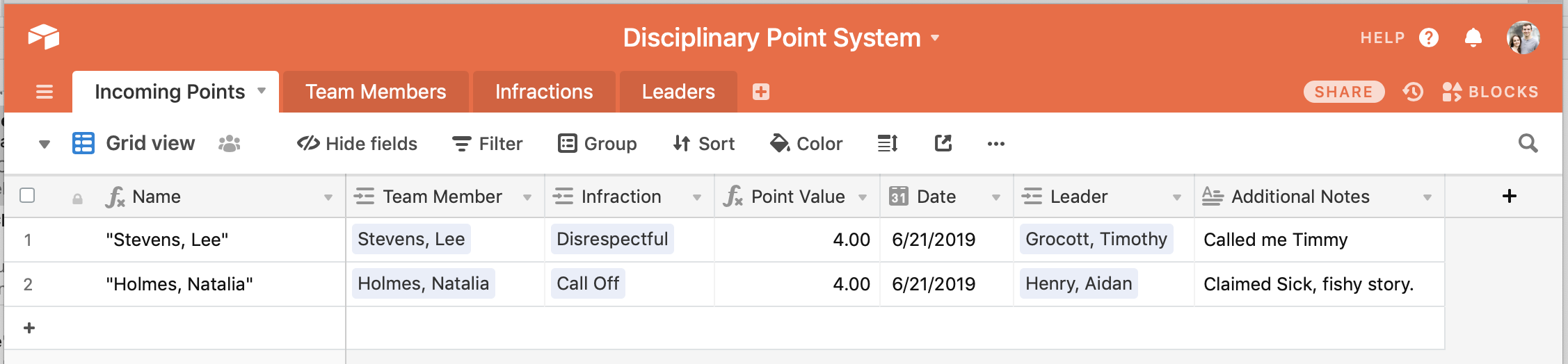

I am creating a tracking system for a point system for tracking Team Member Infractions.
This is the main Table:

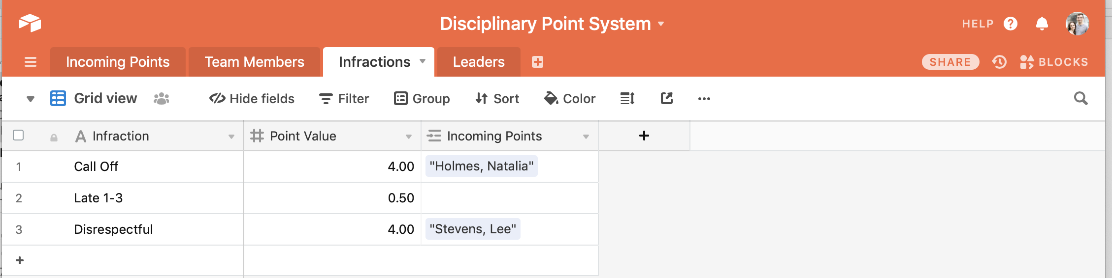

This is the reference table:
The reference table will be mostly static. The list will be longer, this is just for an example until I know it works.
On the main Table [Incoming Points], we will use a form to populate it. the list of options is already linked to the {Infraction}. I just want to make the {Point Value} also carry over into the column right next to it.

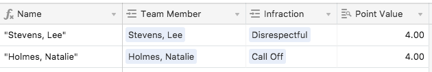

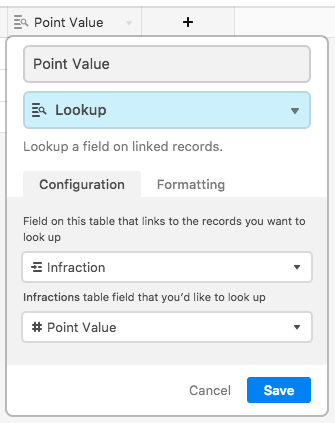

That makes much more sense. Because your infractions aren’t just text, they’re links, you can simply use a lookup to pull in the associated point value. Here’s a simplified recreation of your setup, using the lookup field on the [Incoming Points] table to pull relevant points from [Infractions]:
Wow. that’s exactly what I needed! thank you so much! I really appreciate your help!
