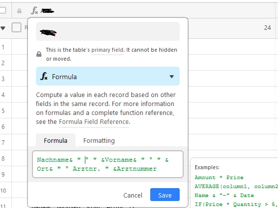

Hi! You could do that with the formula feature. Just klick formula and then select the column you need. You can also combine that feature with several rows.

I use this formula for collecting several columns into one column in the same table.
For Rollup you might need the “if” funtion or “count” function in the formula field.
