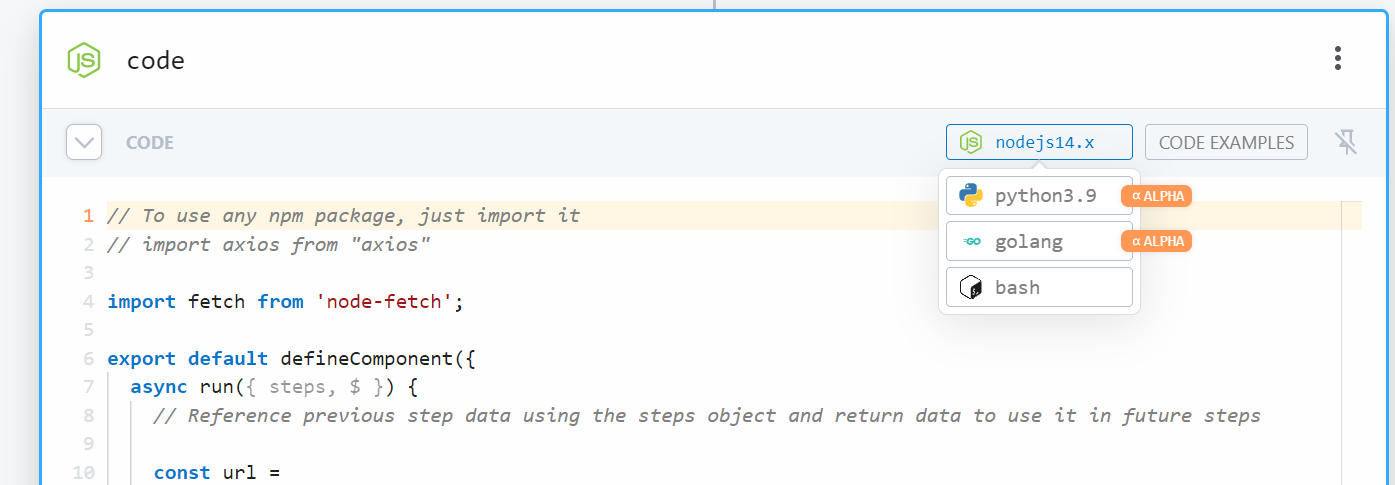

Hi @Sara
If you are need to use Python for some specific reason - you can always use Airtable scripting to send data to service like Pipedream.com run Python script there and return the data. Also for JS you can import node modules there.
Other options include Go and Bash😮
In theory you can also run Python scripts in Zapier, but that sounds like terribly painful idea.
