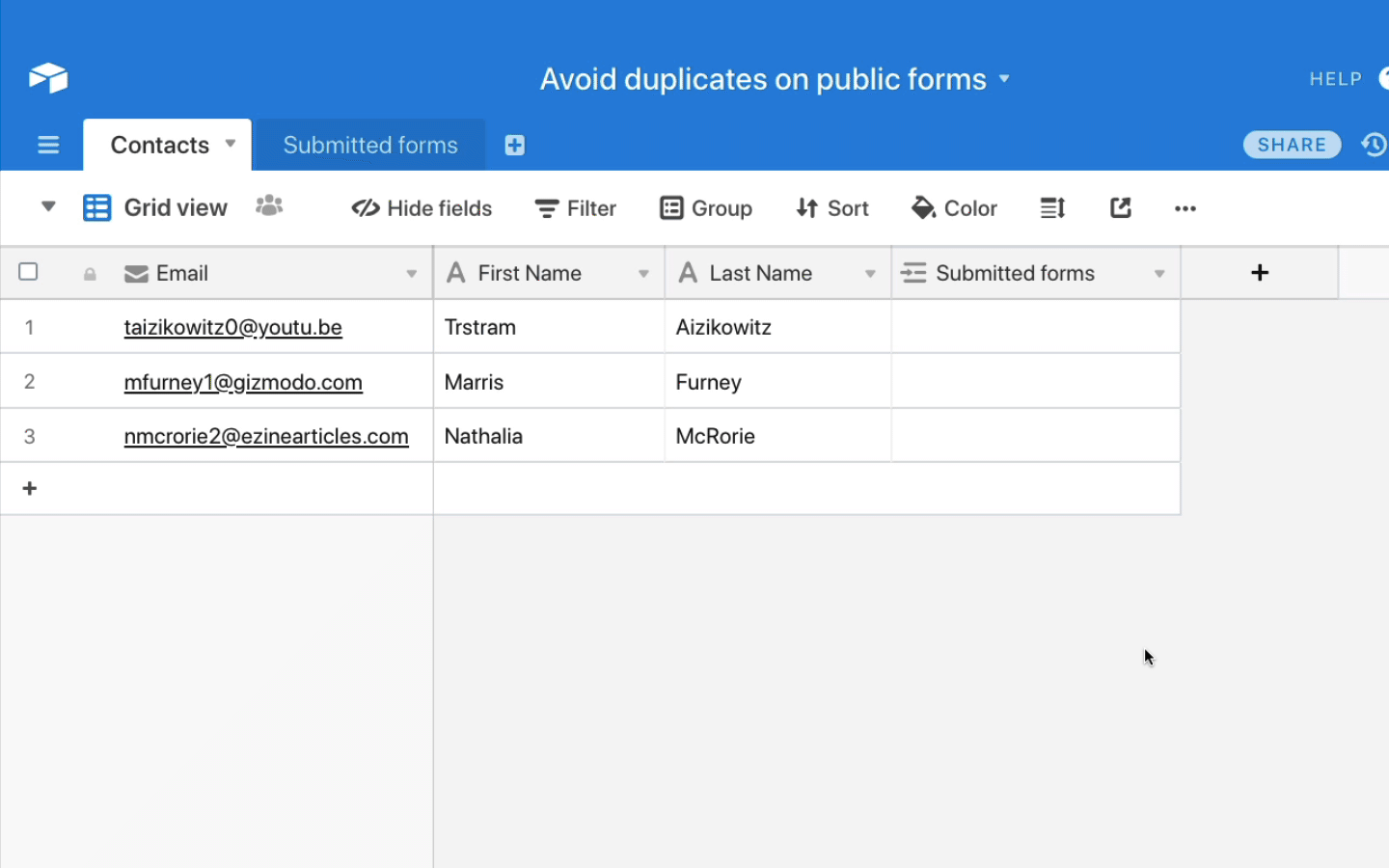

The good news is, as you can see in the Gif below, You can do that in 2 clicks by simply copy pasting in the Submitted forms table the whole Email column in to the Linked Record column.
Note the submitted forms records 3 and 4 came from the same contact. As a result, both forms were linked to the contact number 3.
With the right structure in place, Airtable is able to handle duplicates for you :
  • If the Email (primary key) does not exist in the Contact table, Airtable will create a new record (contact record 4).
  • But if the Email already exists, Airtable won’t create a new record, but will link the submitted forms to the existing contact.
