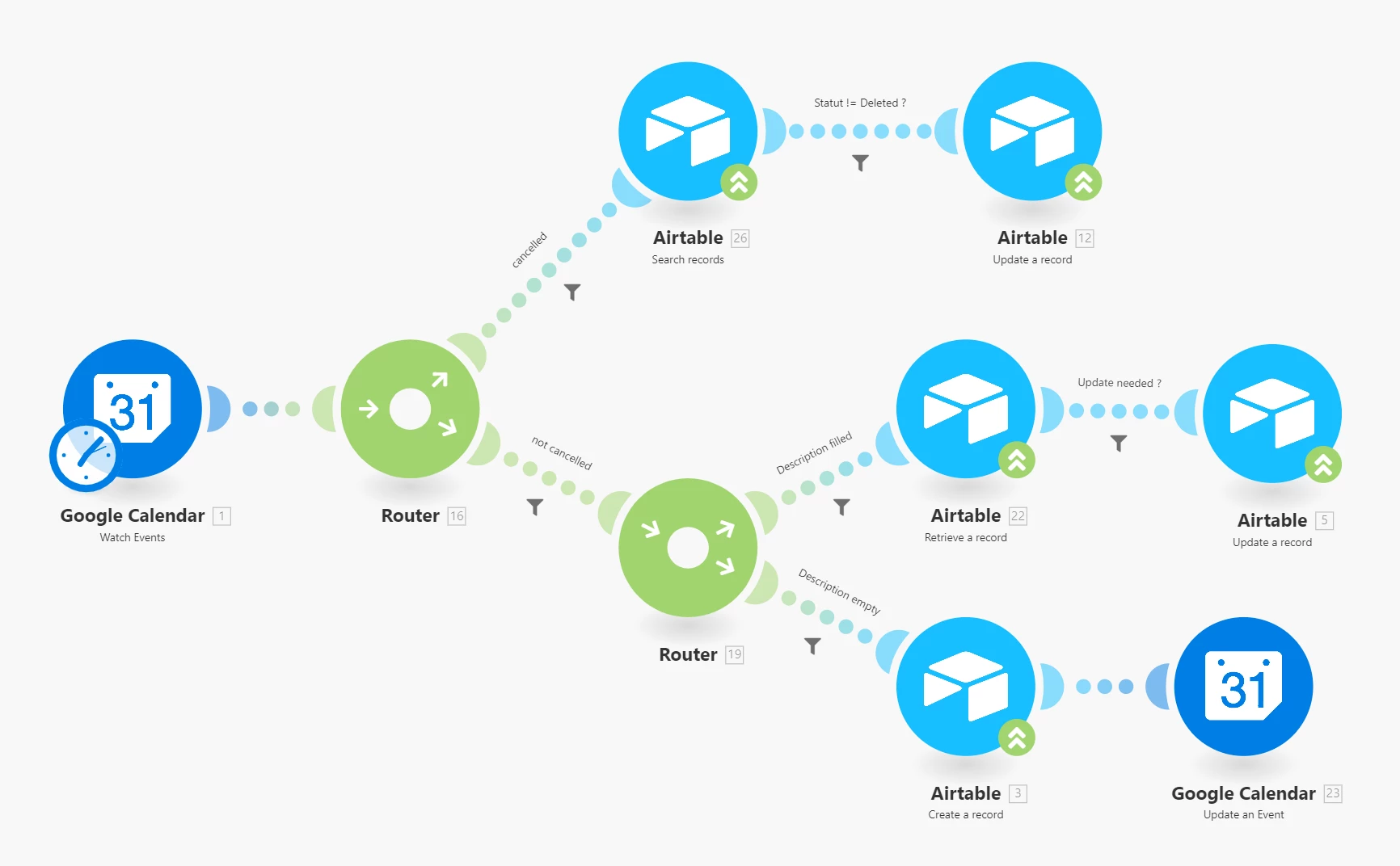

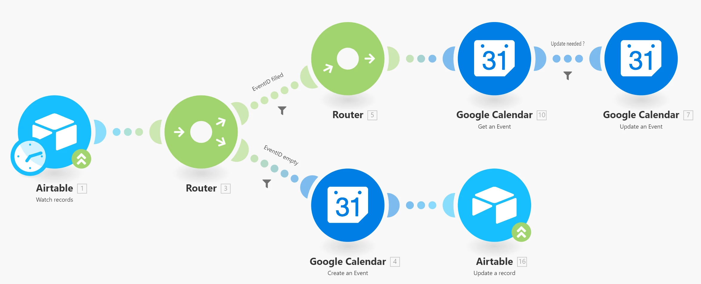

Hi Paul !
Since then, I have built my own Node.js sync robot hosted on my own server, since I wanted more automation specific to my use case.
First, I advise you to check the latest news directly on the AirTable website : they have enabled automation services (“Automations”). AirTable is becoming more and more awesome as time passes !
If you still want to use Integromat, here are snapshots of what I built at the time :
Hope it helps !
Happy AirTabling !

This is very helpful! Any chance you could post screenshots of the fields/mapping within each of the modules?
